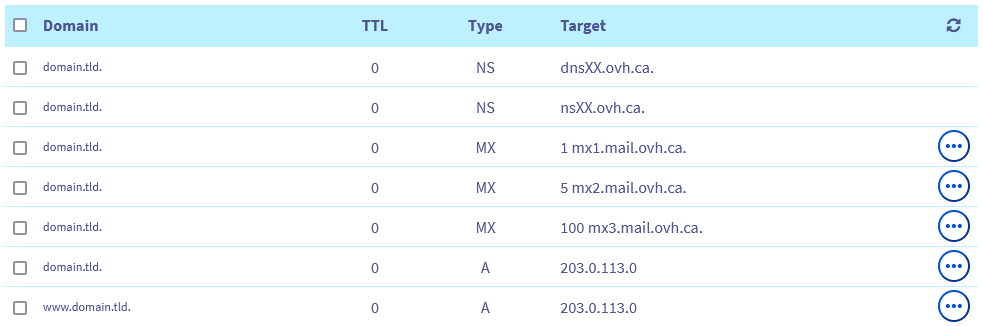

DNS zone example
To better represent what a DNS zone is, below is an example of a DNS zone hosted at OVHcloud for the domain name domain.tld. This is configured on the dnsXX.ovh.ca and nsXX.ovh.ca OVHcloud DNS servers:
DNS zone dashboard
In comparison, here is its equivalent in text mode:
$TTL 3600
@   IN SOA dnsXX.ovh.ca. tech.ovh.net. (2024051800 86400 3600 3600000 60)
                 IN NS     nsXX.ovh.ca.
                 IN NS     dnsXX.ovh.ca.
                 IN MX     1 mx1.mail.ovh.ca.
                 IN MX     5 mx2.mail.ovh.ca.
                 IN MX     10 mx3.mail.ovh.ca.
                 IN A      203.0.113.0
www              IN A      203.0.113.0
In this example, the DNS zone specifies, among other things, the following information for DNS queries that reach it:
  • The DNS servers declared for the domain name domain.tld are the DNS servers dnsXX.ovh.ca and nsXX.ovh.ca.
  • The server must return the IP address 203.0.113.0 if a DNS request is made to the domain name domain.tld or the subdomain www.domain.tld. For example, you can find the website domain.tld behind the IP address 203.0.113.0.
  • For emails, the DNS zone indicates that DNS queries made for @domain.tld email addresses must be sent to the mx1.mail.ovh.ca server as a priority. If it takes too long to respond or is unavailable, the request will then be sent to the mx2.mail.ovh.ca server, and so on until the last server that was declared mx3.mail.ovh.ca.
  • The SOA (Start Of Authority) of the OVHcloud DNS zone indicates that the last update date of the DNS zone is 18/05/2024 and that the refresh time of the DNS zone is 3600 seconds. In DNS zones hosted elsewhere than at OVHcloud, the SOAs may contain other elements such as the email address of the DNS zone administrator. For security reasons, OVHcloud has chosen not to display this information in the SOA.
