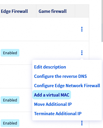

Assign a virtual MAC address
In the case of a block of IPs, virtual MAC addresses are created on each individual IP in the block.
You can use the drop-down menu underneath My public IP addresses and associated services and select All Additional IPs to filter your services accordingly, or directly type the desired IP address in the search bar.
manage IPs

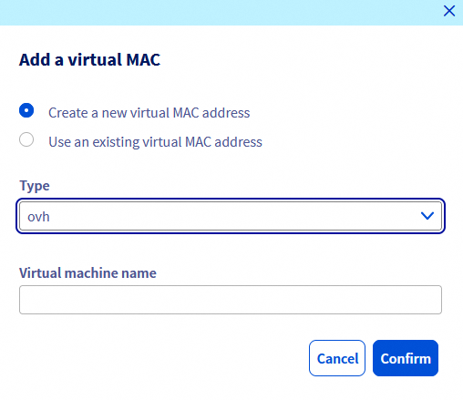

Next, locate your Additional IP address in the table and click the button to open the menu. Select Add a virtual MAC.
Add a virtual MAC (1)
Choose ovh from the "Type" drop-down menu unless you are using VMware ESXi - in that case choose vmware. Type a name in the “Name of virtual machine” field, and click on Confirm.
Add a virtual MAC (2)
After a few seconds, a virtual MAC will appear in the "Virtual MAC" column of your Additional IP row. This virtual MAC will be required when configuring your VM on the host.

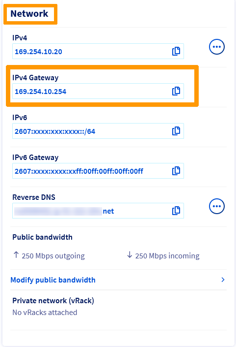

Determine the gateway address
To configure your virtual machines for Internet access, you need to know the gateway of your host machine, i.e. your dedicated server.
You can retrieve the gateway address via your customer area or the OVHcloud API.
The IPv4 gateway assigned to your server will appear in the Network section of the General Information tab. Once you have copied it, continue with applying the configuration.
gateway
On the OVHcloud API page, click on Login in the top right-hand corner. On the next page, enter your OVHcloud credentials.
Execute the following API call, indicating the internal server name (example: ns3956771.ip-169-254-10.eu):

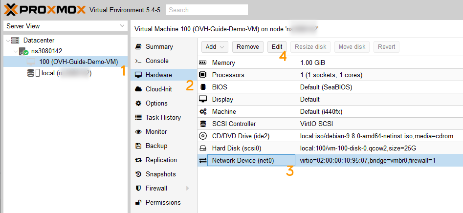

After creating the VM and while it is still powered off, right-click the VM and click Edit settings.
  1. Select the VM.
  2. Open the Hardware section.
  3. Select Network Device.
  4. Click the Edit button.
navigate to Network Device

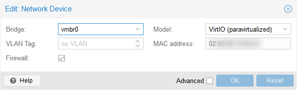

Then add the virtual MAC address created previously.
open Network Device
Now you can start the VM and proceed with the configuration steps, depending on the operating system installed.

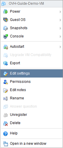

The following instructions apply to a previously created VM with an OS already installed. If you have not created a VM, please review the guide Create a Virtual Machine in the VMware Host Client on the VMware page.
After you've created the virtual machine and while it's powered off, right click the VM and click Edit settings.
VM context menu
Fold out Network Adapter 1, change the value in the MAC Address drop-down menu to Manual and enter the virtual MAC address created previously.
Edit settings

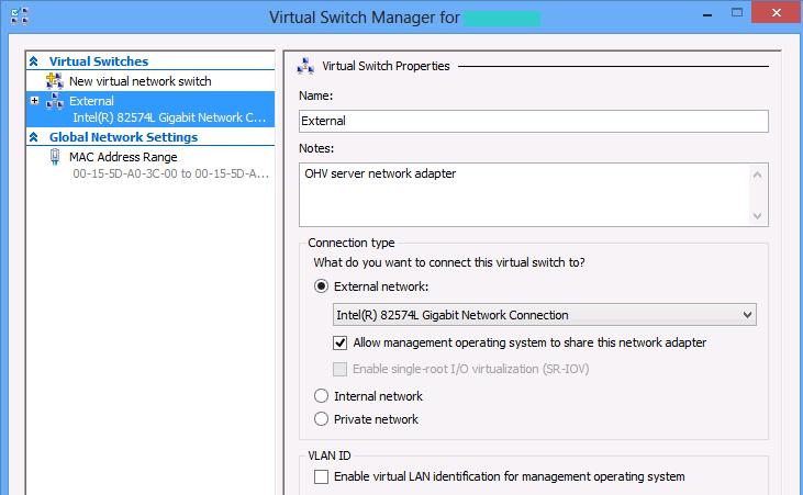

Before configuring your virtual machine, you need to create a virtual switch.
From the command line of your dedicated server, run the following command and note the name of the network adapter that contains the server's main IP address:
ipconfig /all
In the Hyper-V Manager, create a new virtual switch and set the connection type to External.
Select the adapter with the server’s IP, then tick the option Allow management operating system to share this network adapter.
Hyper-V Virtual Switch Manager with External network type
This step is only required once for a Hyper-V server. For all VMs, a virtual switch is required to connect the VM’s virtual network adapters to the server’s physical adapter.

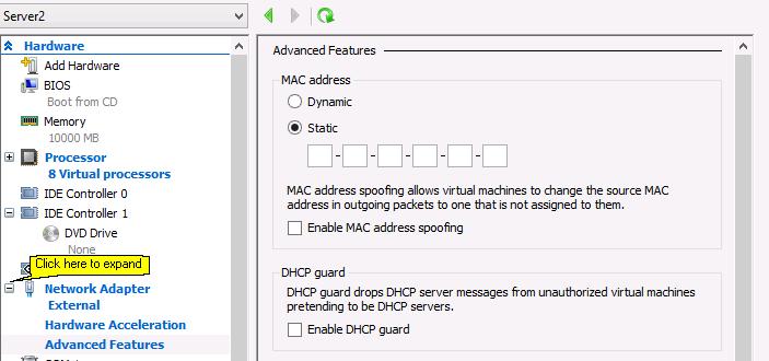

Next, select the VM you wish to add the Additional IP to. Use the Hyper-V Manager to change the settings of the VM and shut it down.
Expand the network adapter in the left-hand menu and click on Advanced Features. Change the MAC address to Static, and enter the virtual MAC address for the Additional IP. Once you have entered these settings, press OK to apply the changes.
VM network adapter settings with static MAC address

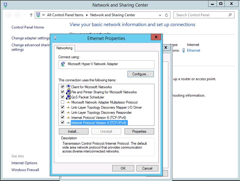

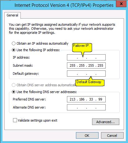

Next, start the VM and log in as an administrator, then go to the Control Panel's Network and Sharing Center. Click on Ethernet to open the settings and click on the Properties button to view the Ethernet Properties.
Select Internet Protocol Version 4 (TCP/IPv4), and then click on the Properties button.
Ethernet Properties with TCP/IPv4 selected
In the IPv4 Properties window, select Use the following IP address. Enter the Additional IP into the IP address field, and enter 255.255.255.255 into the subnet mask.
Fill in your server’s gateway IP address in the appropriate field below and enter 213.186.33.99 into the Preferred DNS Server field.
Finally, click OK, and ignore the warning message about the gateway IP and the assigned IP not being in the same subnet.
IPv4 Properties with Additional IP and gateway configured
After rebooting the server, the VM should be connected to the internet using the Additional IP.
