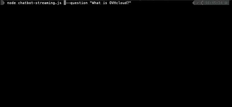

Run your streaming chatbot with:
node chatbot-streaming.js --question "What is OVHcloud?"
You’ll see the assistant’s response appear in real time ⏳💬
