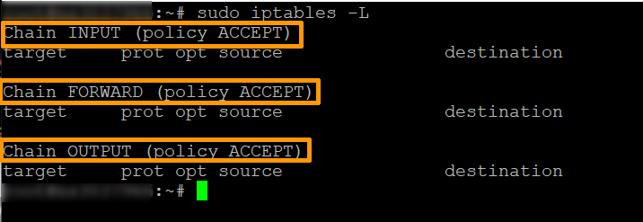

Step 3: Check the current status of iptables
To display all of the current rules on your server, enter the following command in the terminal window:
sudo iptables -L
The system displays the status of your channels.
The output will list three strings:

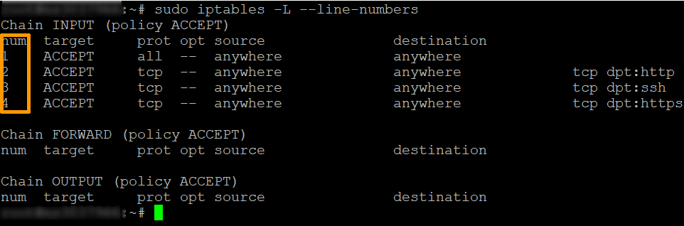

Step 8: Delete a rule
A more precise method is to delete the line number of a rule.
sudo iptables -P INPUT DROP
First, list all rules by entering the following:
sudo iptables -L --line-numbers
line-numbers
Locate the line for the firewall rule you want to remove and run this command:
sudo iptables -D INPUT <Number>
Replace Number with the rule line number you want to delete.
