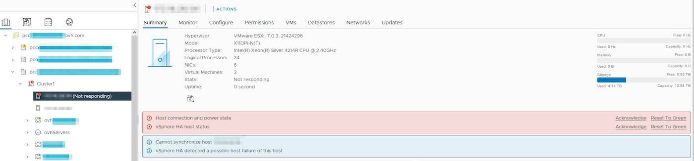

The host will then be disconnected and switch to "No response" mode until the test is complete:
