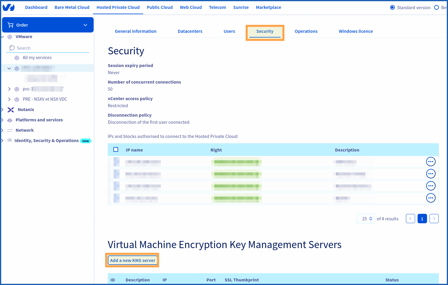

Click this link to access the VMware vSphere section, then select your service and click Security.
Manager Add Kms
Further down the page is the "Virtual Machine Encryption Key Management Servers" section. Click the Add a new KMS server button.
server KMS
In the new window that opens, enter the following information:
  • The KMS IP address.
  • The SSLThumbprint of the KMS Server you previously retrieved.
Confirm that you read this documentation, then confirm by clicking Next.
server KMS

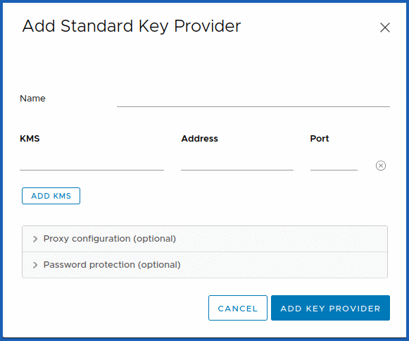

Click Add > Add Standard Key Provider.
Add KMS
Then specify the KMS information in the configuration wizard that appears:
Add KMS

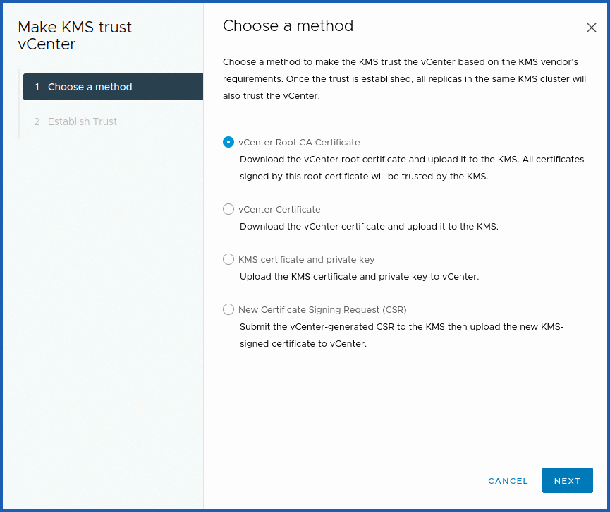

Importing KMS certificate
Most KMS providers require a certificate to establish a secure connection with the vCenter.
From the vCenter on which you added the KMS server, select it. In "All options", click Establish a trusted link with KMS.
Ensure that the certificate is not encrypted with a password when you download it from the KMS. For example, if you create a user, create one without a password and download the certificate for the KMS user.
import KMS certificate

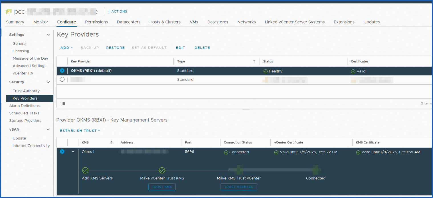

Check that the KMS is configured
Verify that the "Connection Status" corresponding to the KMS is in "Normal" mode.
verify connection status

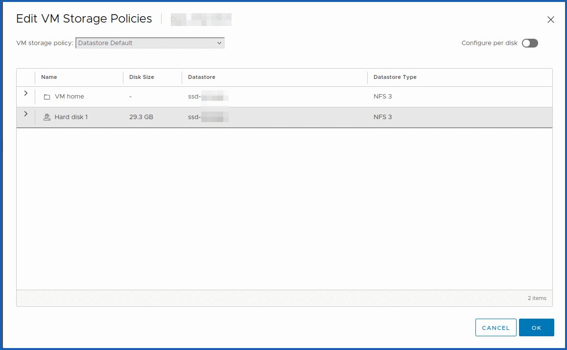

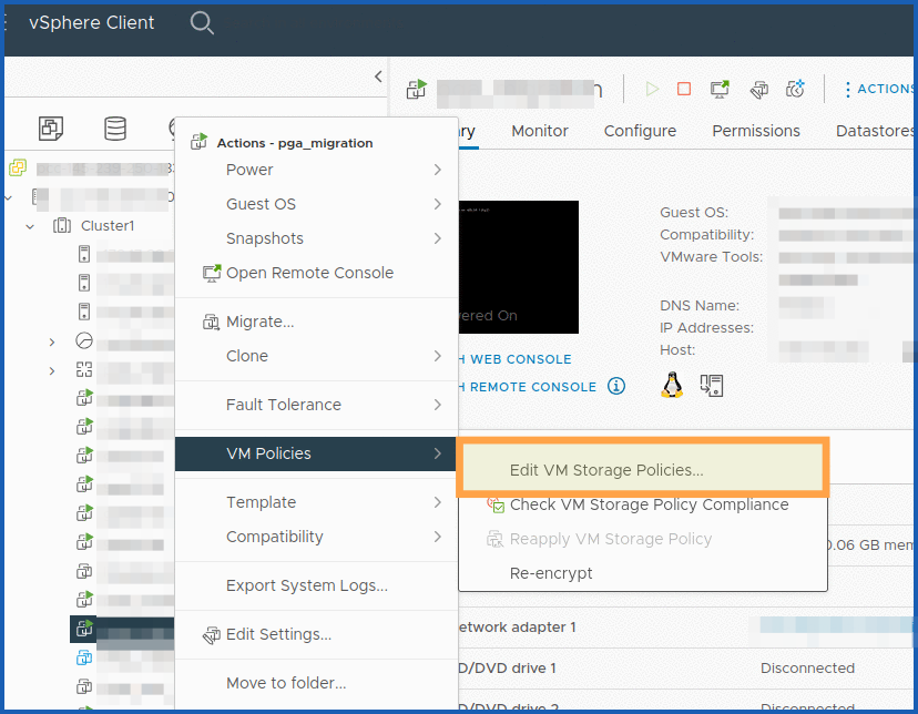

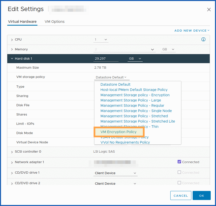

Modify the storage policy of "VM Encryption Storage"
Create a virtual machine. Once you have created it, right-click it. Click VM Policies then Edit VM Storage Policies.
VM encryption storage
Select the virtual machine files and other hard drives that need to be encrypted.

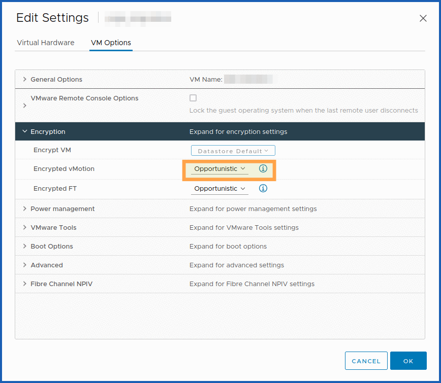

Then modify your virtual machine and click VM Options
You must select the options if your vMotion needs to be encrypted. There are three policies for encrypted vMotion:
StatusDescription
Disabled- Off
Opportunities- Encryption only if supported by the source host and ESXi target host. Otherwise, vMotion will not be encrypted
Required- Encryption will be used
encrypted vMotion

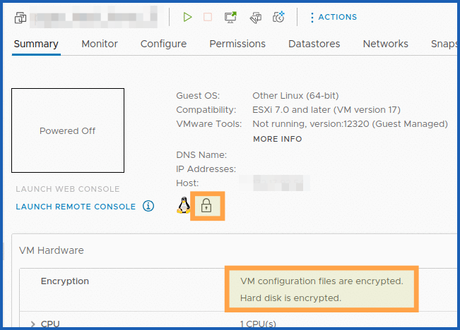

Check that a small padlock is visible, and that the disk is correctly encrypted in your VM information.
Check your VM settings to ensure that your storage policy is the one that uses VM encryption Policy.
