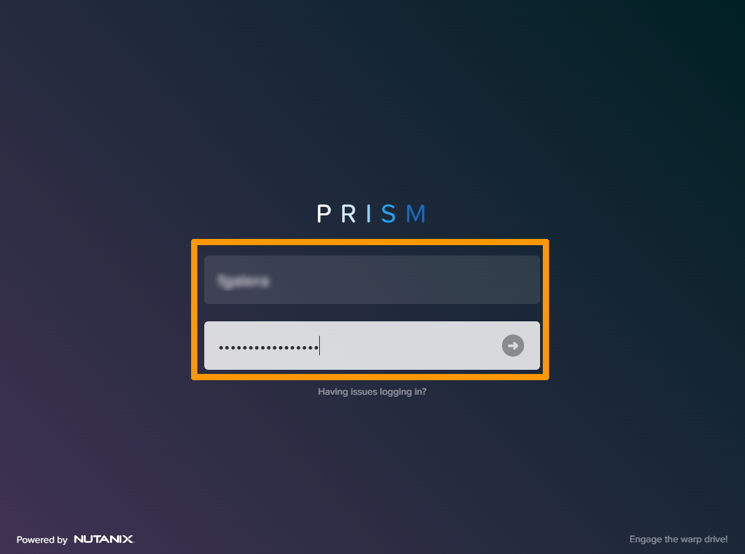

Interface Prism Central - Login
Enter your username and password and click the arrow.

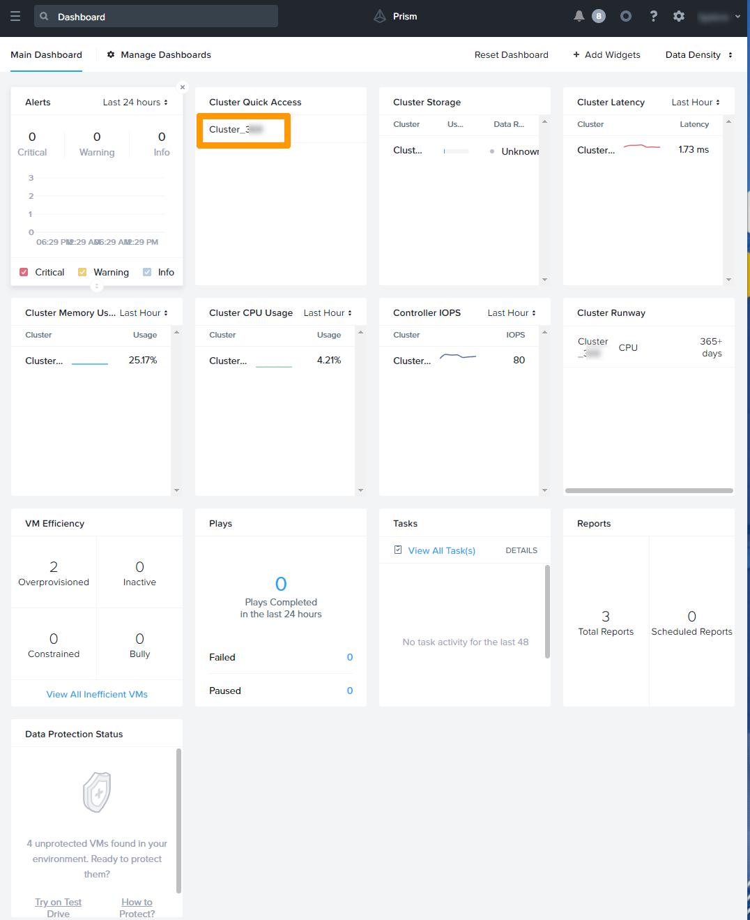

Interface Prism Central - Dashboard
Connecting to Prism Element via Prism Central
On the Prism Central Dashboard, click the cluster name in the Cluster Quick Access frame.

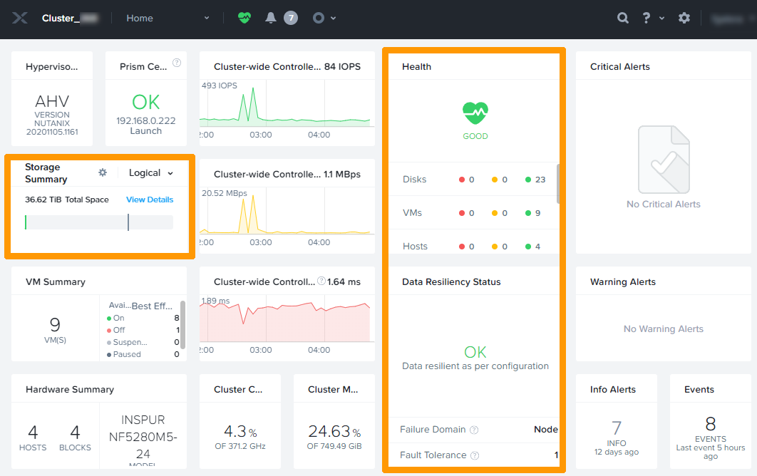

You will then access your cluster’s dashboard.
To the right is the total number of disks, the number of VMs, and the number of hosts.
A green heart indicates that the Nutanix cluster is functioning correctly.
At the bottom of this section, you will see the fault tolerance level (1 means we are in RF2 with the possibility of a disk loss on a node or failure of an entire node).
A summary of the storage and available disk space is displayed on the left.

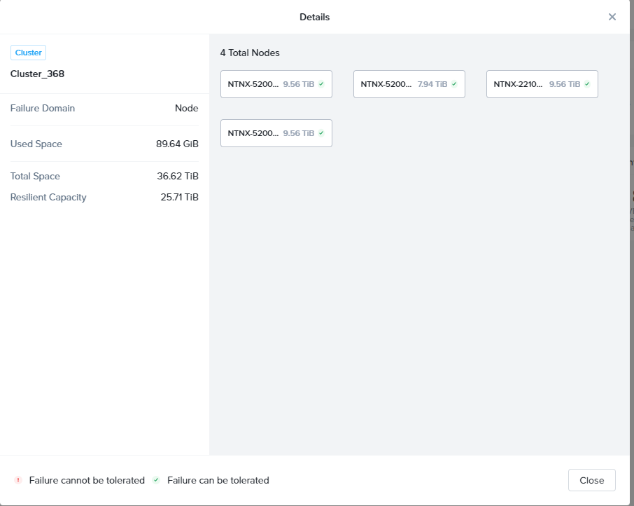

Click View Details for more information about storage.
Interface Prism Element - DashBoard
This allows you to check the storage status by node.

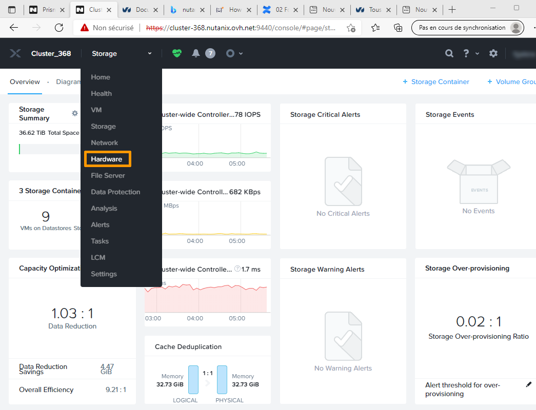

Storage
Click on the Hardware menu to view the details of the storage per node, as well as the number of disks allocated per node.
Hardware Menu

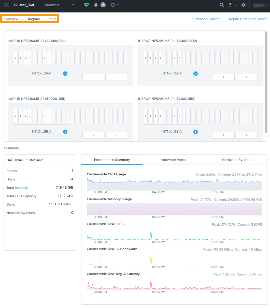

Click Diagrams for a graphical summary as shown below.
Hardware Detail
