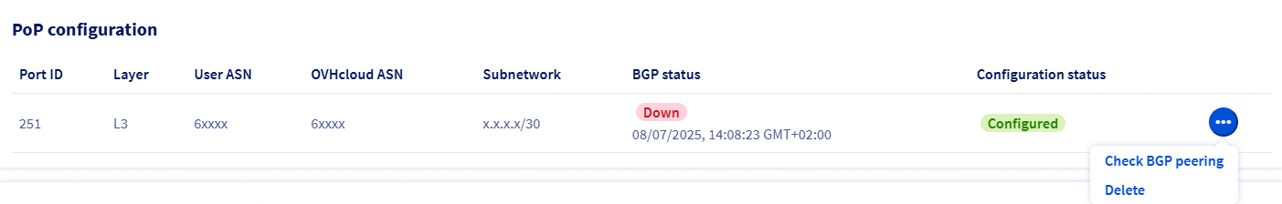

The PoP configuration menu will then appear.
ajout PoP

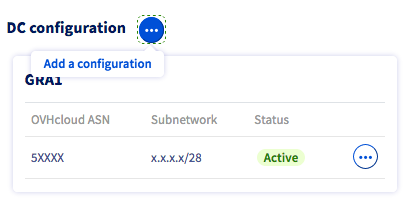

When your PoP configuration is active, click Add a configuration under the AZ configuration menu. Select an availability zone from the drop-down menu and confirm.
add AZ
add AZ

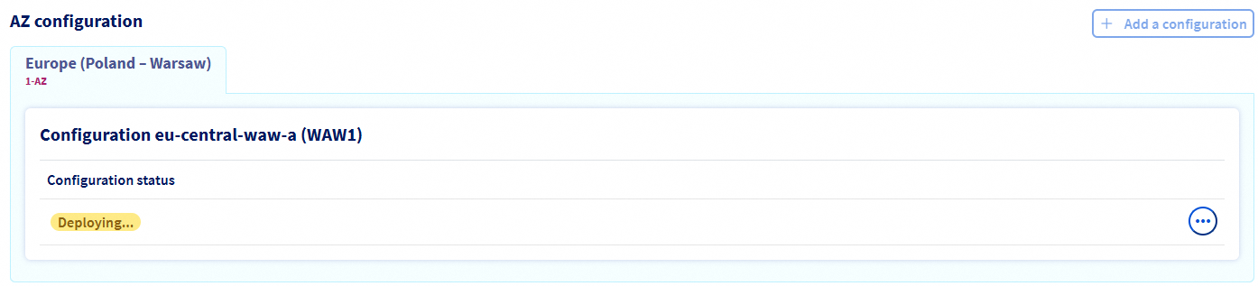

The AZ configuration will then begin.
add AZ

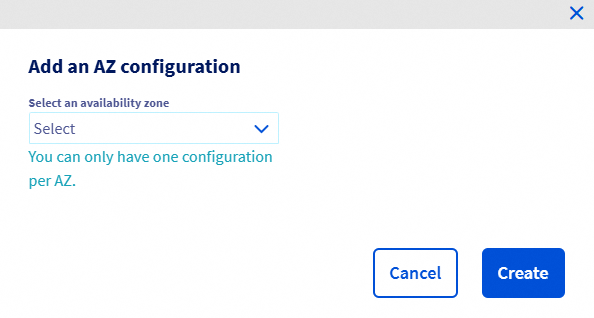

When your PoP configuration has been set, click Add a configuration under the AZ configuration menu.
add AZ

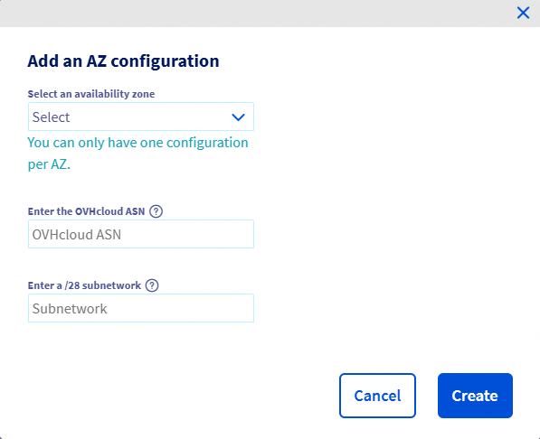

Select an availability zone from the drop-down menu, then enter the information required.
InformationDescription
OVHcloud ASNThe OVHcloud AS number that will be configured on the OVHcloud Connect routers located in the AZ. This number may be different from the ASN chosen for the PoP
A /28 subnetworkA private subnetwork configured in your vRack in the selected AZ. This can be an IPv4 block of size /28 or higher

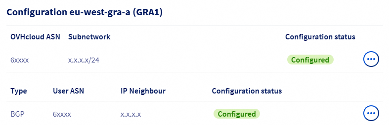

You can add additional availability zone configurations by clicking on the + Add a configuration button.
add AZ

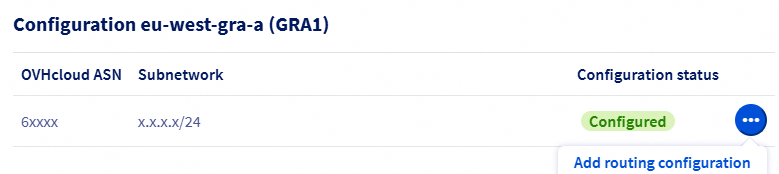

Click on the (...) button on the desired availability zone then on Add routing configuration.
add routing configuration

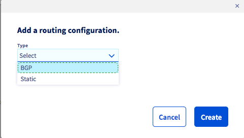

Then choose the routing type between Static and BGP.

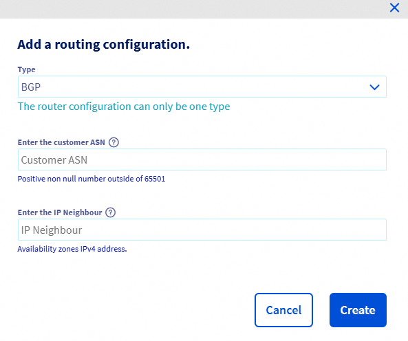

If you choose the type BGP, then enter the required information.
Customer ASNYour AS BGP number, which is configured on your router located in the AZ
IP NeighbourIP address of the BGP neighbour of your router in the AZ. This address must be part of the subnetwork specified in the AZ Configuration section

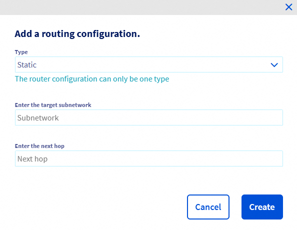

If you choose the Static type, enter the required information:
Network FocusA prefix using CIDR notation
Next hopAn IP address acting as gateway in the subnetwork range
